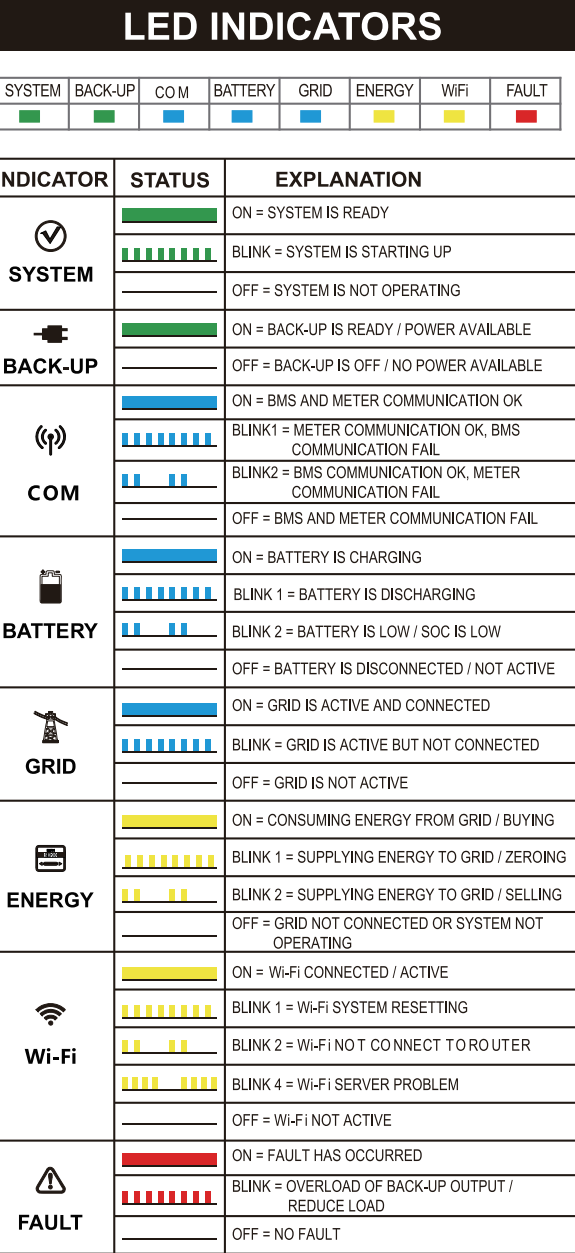

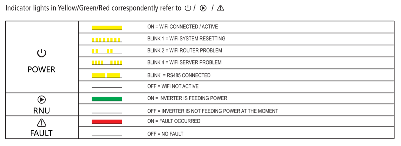

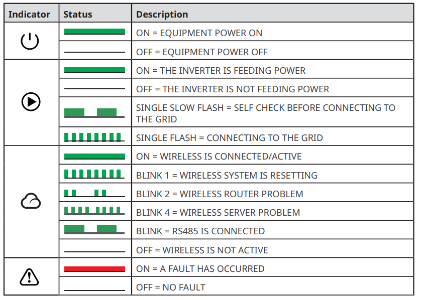

The easiest way to identify Wi-Fi issues is to check what the Wi-Fi indicator on the inverter is showing. It is a graphical explanation what the Wi-Fi indications mean and their associated error message.
For residential grid-tied inverters:
For C&I grid-tied inverters:
For hybrid inverters:
