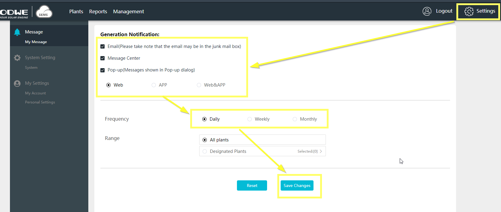

1. E-mails with reports of the generated power are sent out regularly from the SEMS-Portal server to those who have subscribed to this service. If you wish to subscribe to this, please follow the pic as below:
2. If you already have subscribed to this service but are not receiving any e-mails, make sure to check the spam/junk folder and if found there, mark such e-mails as “not spam” to avoid this in the future. At times, we have also been notified from customers that e-mail addresses ending in “@semsportal.com” have been blocked by the internet provider.

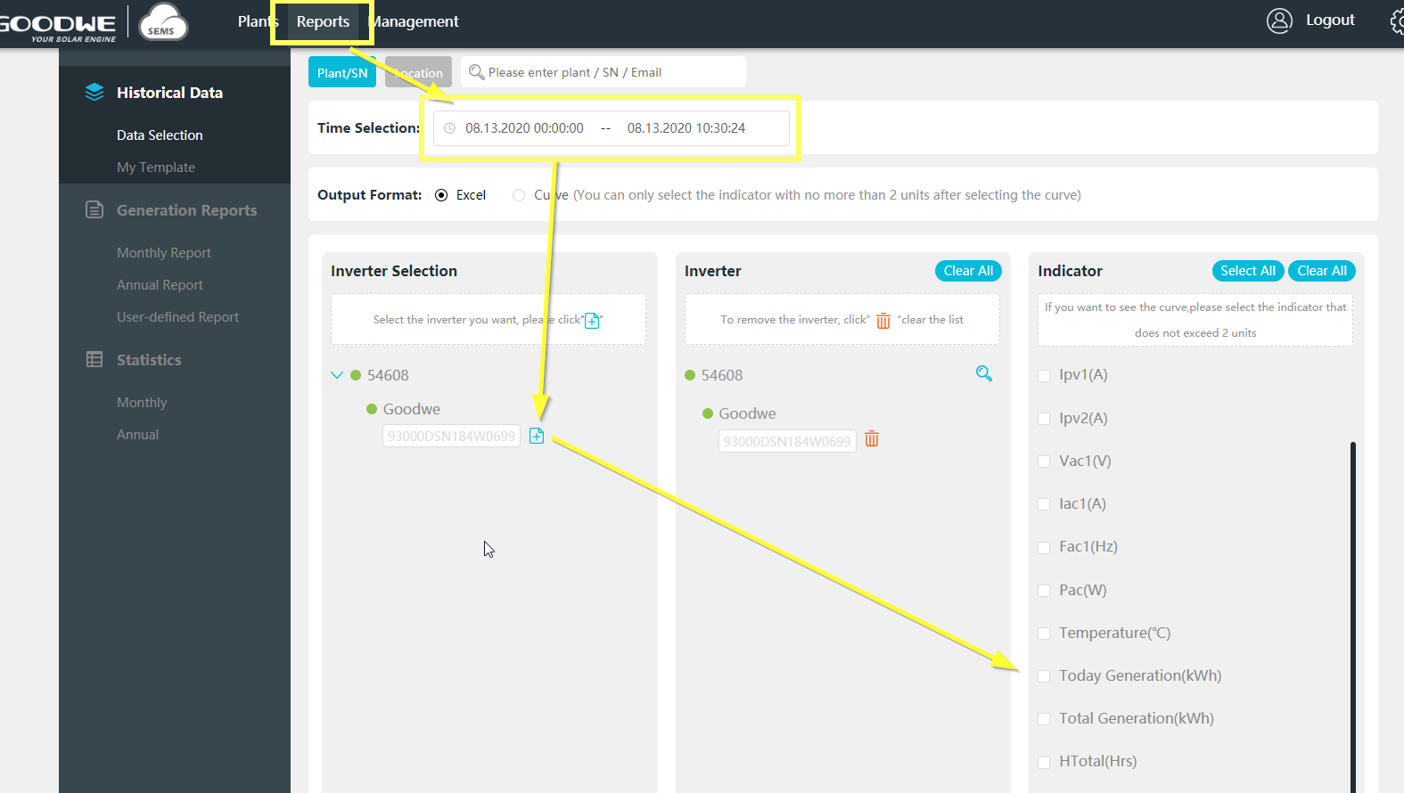

3. If there are difficulties receiving the report by email, the reports can also be generated and viewed directly in the SEMS portal. To create a report of the generated power in SEMS, pls find the pic as below. It is possible to choose monthly, annual and customize the report to your own requirements.
