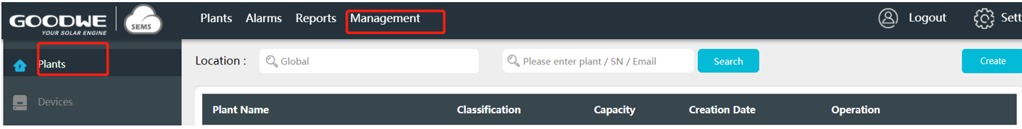

1. Check and confirm if the SN has been added into the Plant. Go to "Management"-->"Device";

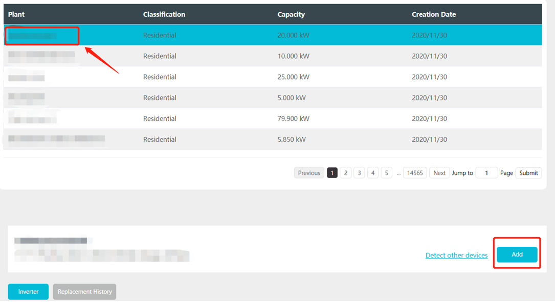

2. Click the plant which you are going to add the device,customer can see the details after clicking the plant:
Click the "Add" button to proceed.
3. Fill in the Name ,SN,Check Code in the blanks and click submit after that.
