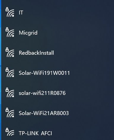

③ Connect to the Inverter’s Wi-Fi
Look for a Wi-Fi network named: Solar-WiFiXXXXXXXX
(The last 8 characters are the final 8 digits of your inverter’s serial number.)
Tap the network to connect. When prompted for a password, enter:12345678

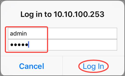

2. Navigate to : 10.10.100.253
3. User Name: ‘admin’
Password: ‘admin’

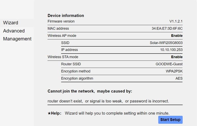

4. Click ‘Log In’ to enter configuration page

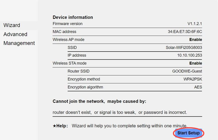

5. Click ‘Start Setup’ to next page

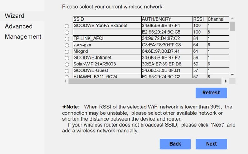

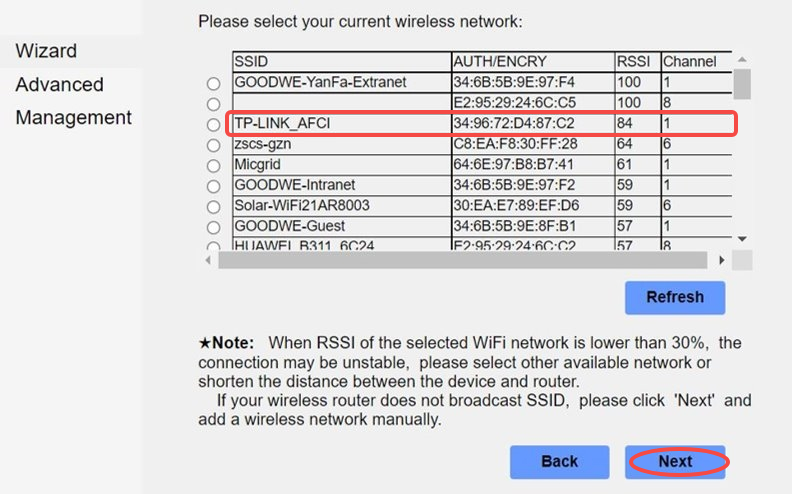

6. Choose WiFi signal of your own router by “Wizard”
7. Then click ‘Next’

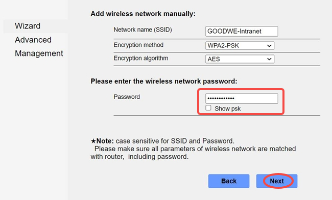

8. Enter the password for router
9. Then tap ‘Next’

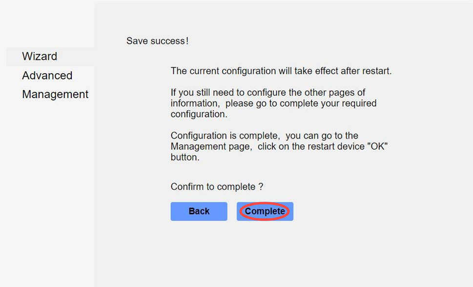

10. Tap 'Complete'
11. Configure successfully
