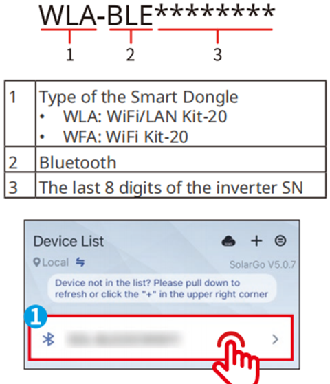

Step 1. Go to SolarGo and refresh the device list, select and connect to WLA/WFA on the list.
Note: For firmware version 1.2.32 or above, it displays the full SN (13 digits) of the inverter instead of the last 8 digits.

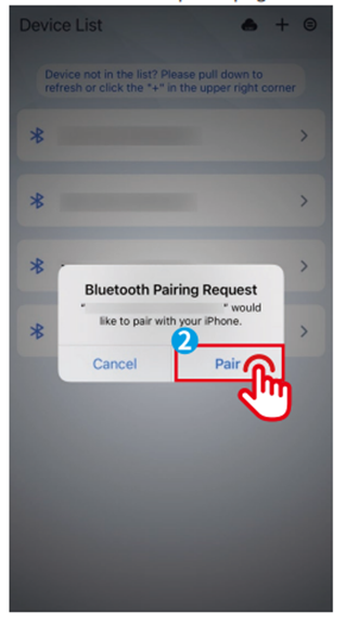

Step 2: Click “Pair” on the popping “Bluetooth Pair Request” page.

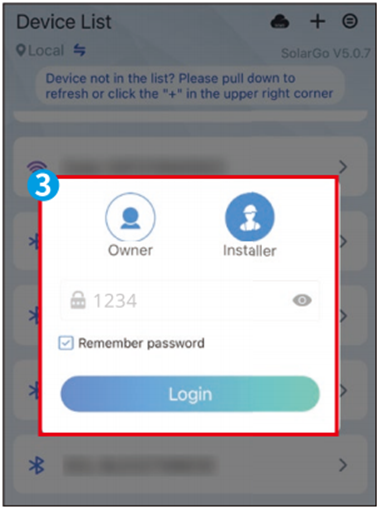

Step 3 (Optional-Only for Grid-Tied PV Inverter): Select "Owner" or "Installer". Then enter the password to log in. The initial password is "1234".

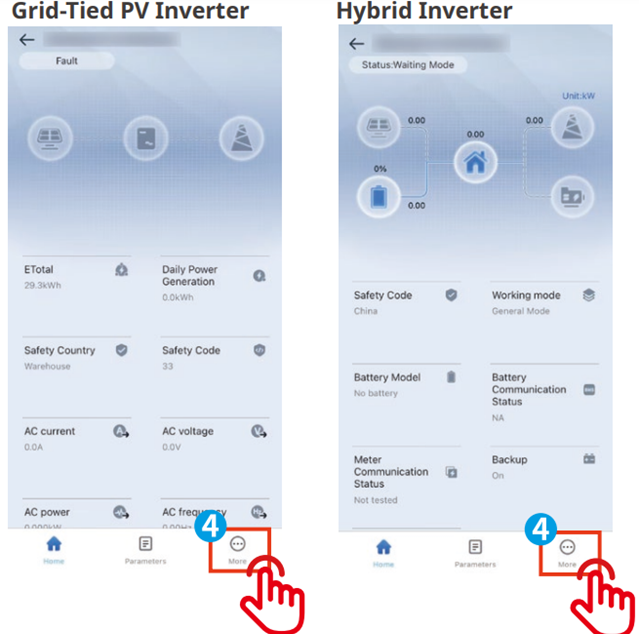

Step 4: Select More/Setting on the right lower corner.

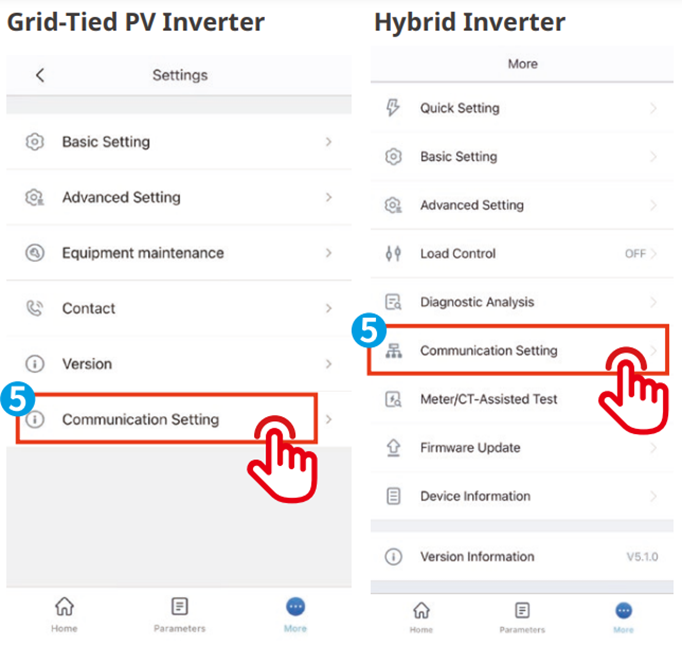

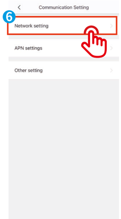

Step 5: Click "Communication Setting", and enter into its sub-page.
Step 6 (Only for Hybrid Inverter) Click "Network Setting", and enter into its sub-page.

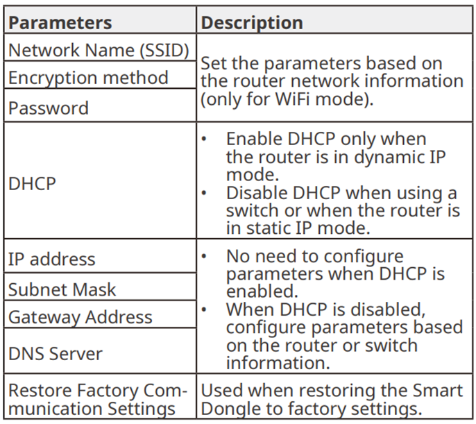

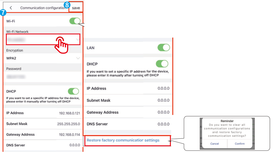

Step 7 Configure the communication parameters according to your requirements.
Step 8 Tap Save to complete the configurations.
Note: Make sure that the WiFi RSSI value is higher than -60, -50 or higher is recommended. When the RSSI value is less than -60, you should move the router closer to the device, remove the obstacle, or add a repeater to improve the signal strength.

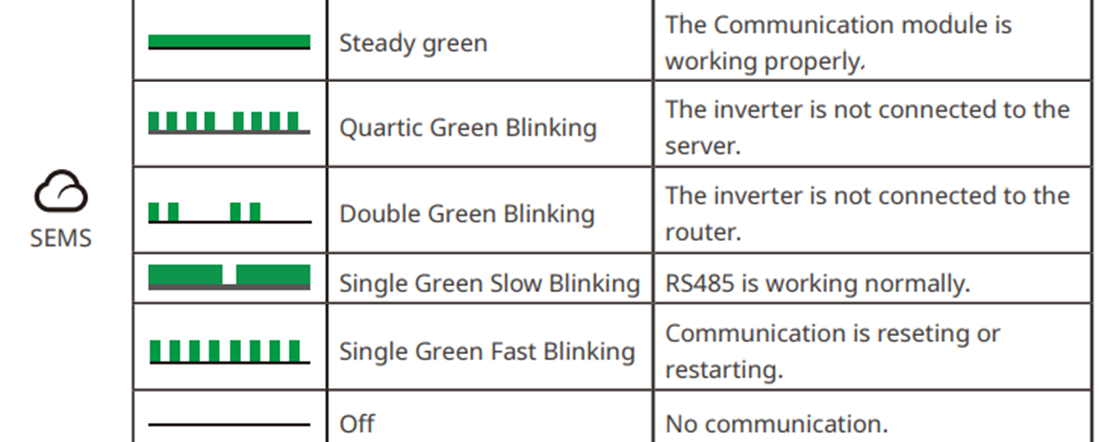

Check the cloud indicator on the inverter and the COM indicator on the module.
