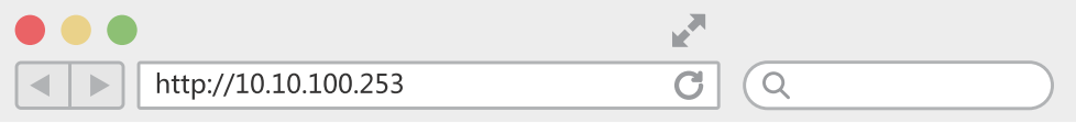

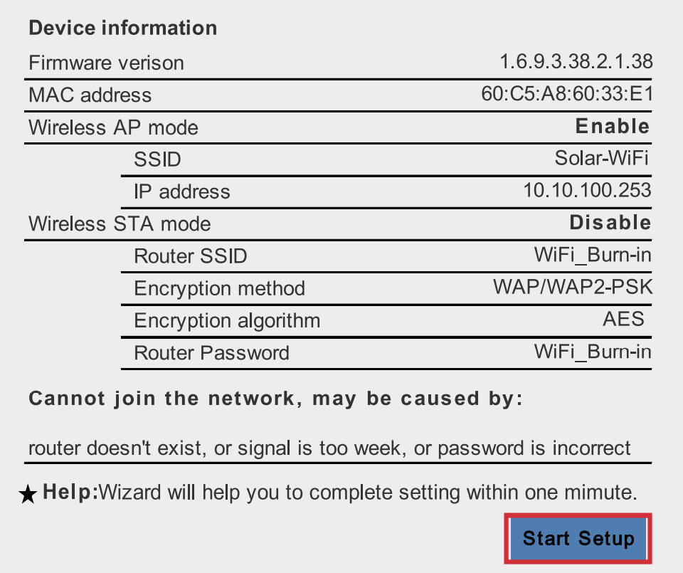

Browse website: http://10.10.100.253
Note: If "Unauthorization Login" appears, please refresh the web browser.

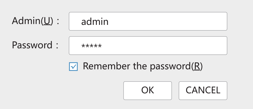

2. Enter User name:'admin'.Password:'admin'
3. Click'Start Setup'

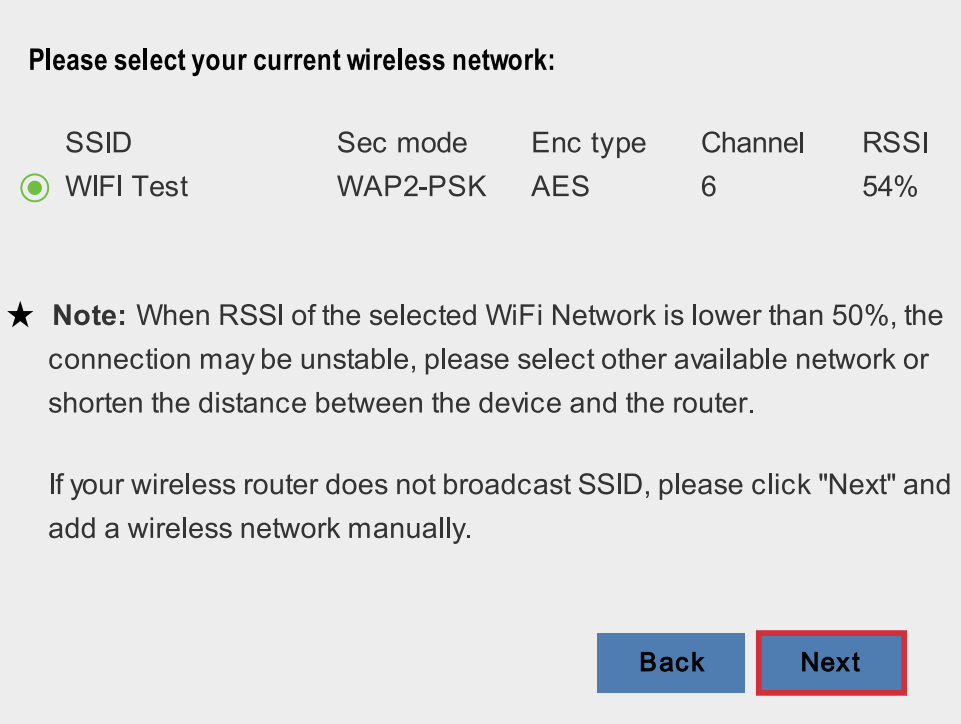

4. Select Wi-Fi router's SSID and click 'Next'

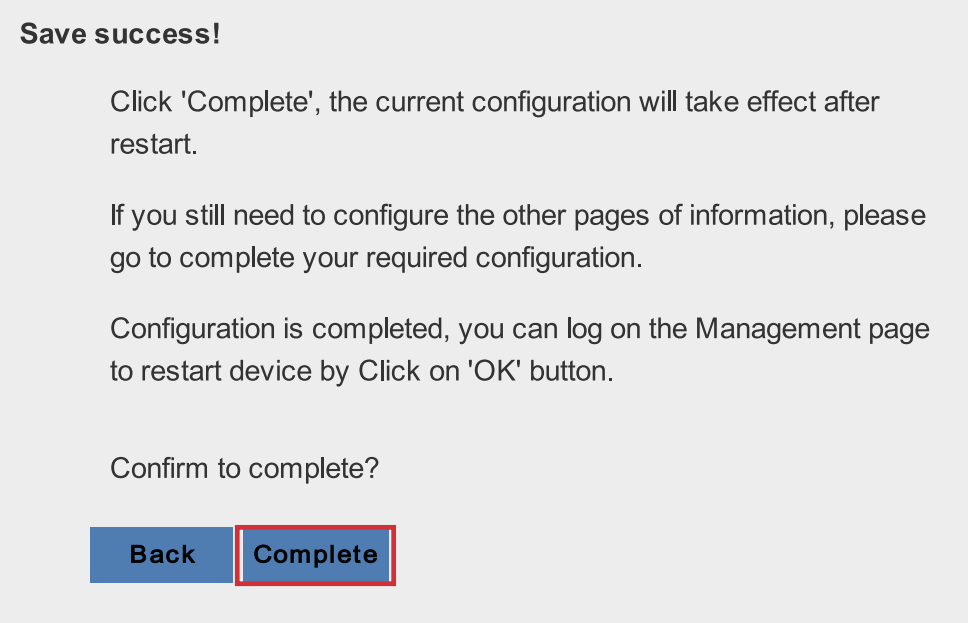

6. Click "Complete" and the configuration process completes.

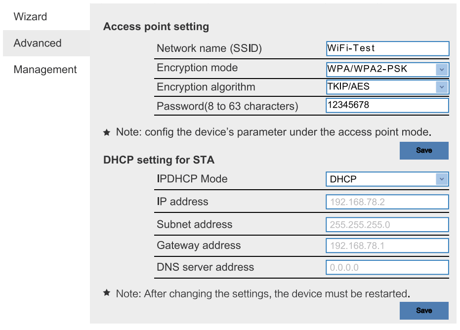

You can modify the Wi-Fi module's SSID or/and password in the "Advanced" interface.
SKIP THIS STEP UNLESS IT IS NECESSARY!

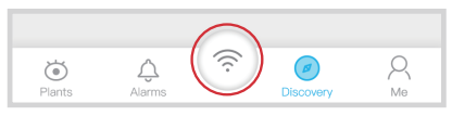

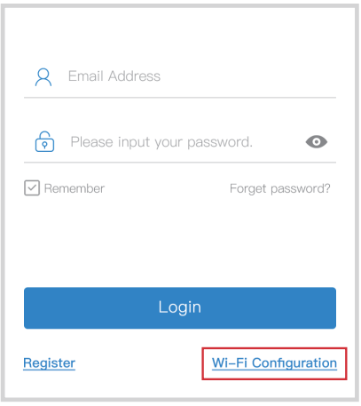

1. Click 'Wi-Fi Configuration" in login page
2. Or click the third one in tab bar

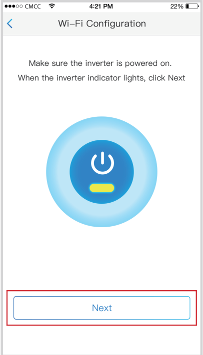

3. Power on inverter, then click "Next"

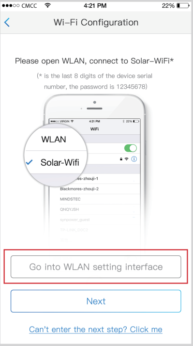

4. Click "Go into WLAN setting interface"

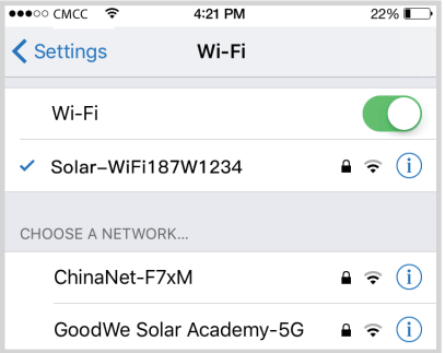

5.Connect to Solar-WiFi (password:12345678) back to App

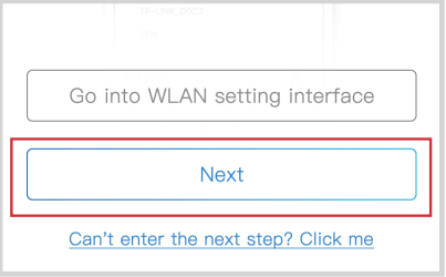

6. Click “Next”

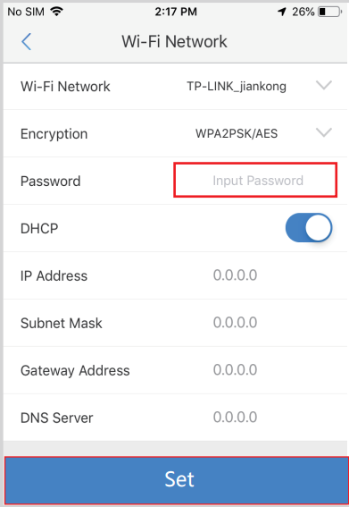

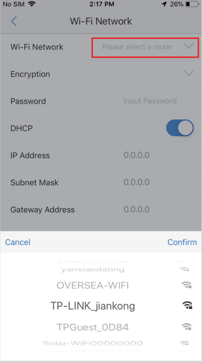

7. Select your WiFi network

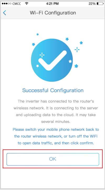

8. Enter password, and click "Set"
Tips :
If you want to set a specific IP to the inverter, switch off DHCP and manually input the IP address, etc.
9. Read the hint before click "OK"

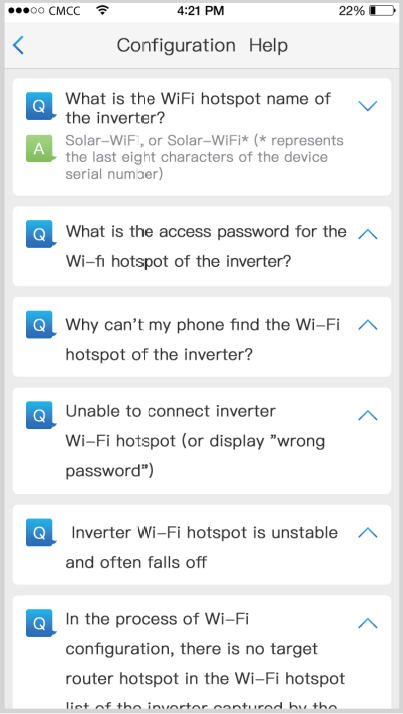

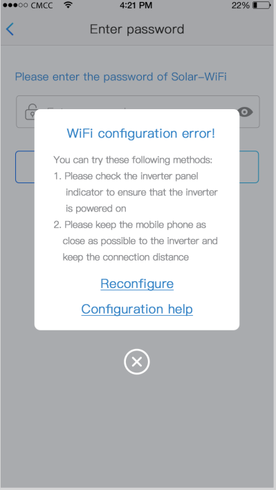

10. If it fails, you can "Reconfigure" or view "Configuration help"
11. Follow up the instructions and try again.
